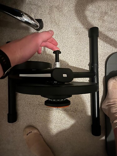

I am trying to install my thru-axle into my trainer (van rysel d100), but it does not fit through. There is what appears to be a quick release attachment on the drive side which I cannot remove. The thru axle only inserts as far as the photo, with correct spacer attached.

That adapter must be removed, there’s no way around it if you want to use a thru-axle
Have you found a way to remove it? I am having the same issue.
I managed to remove it by sticking a 5mm allen key and twisting very hard, not sure if this will help!
