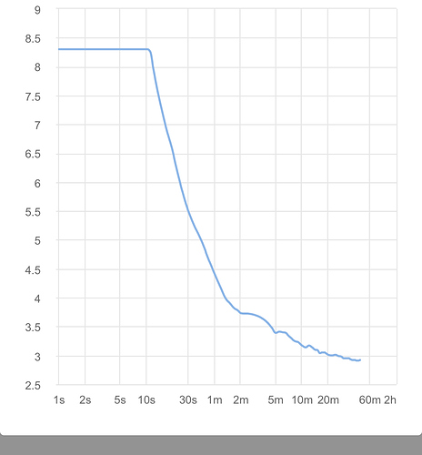

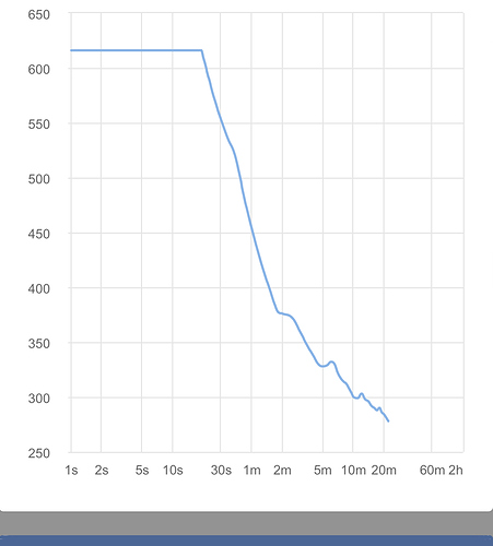

My last 2 races seems that I get throttled when sprinting for the finish line to almost coming to a stop. I use a wahoo snap for resistance and quarq zero power meter for power reading. This has just started happening. Here are two races that I flat line from zwiftpower. I have been zwifting for over 4 years…

My power charts on zwiftpower show a similar flatline for just about every event, anywhere from 10-40 seconds just flat then it drops off with time, sometimes it’s in the 5w/kg range other times it’s higher in the 8-9 w/kg range. Big sprint or not it seems to flatline me just the same
