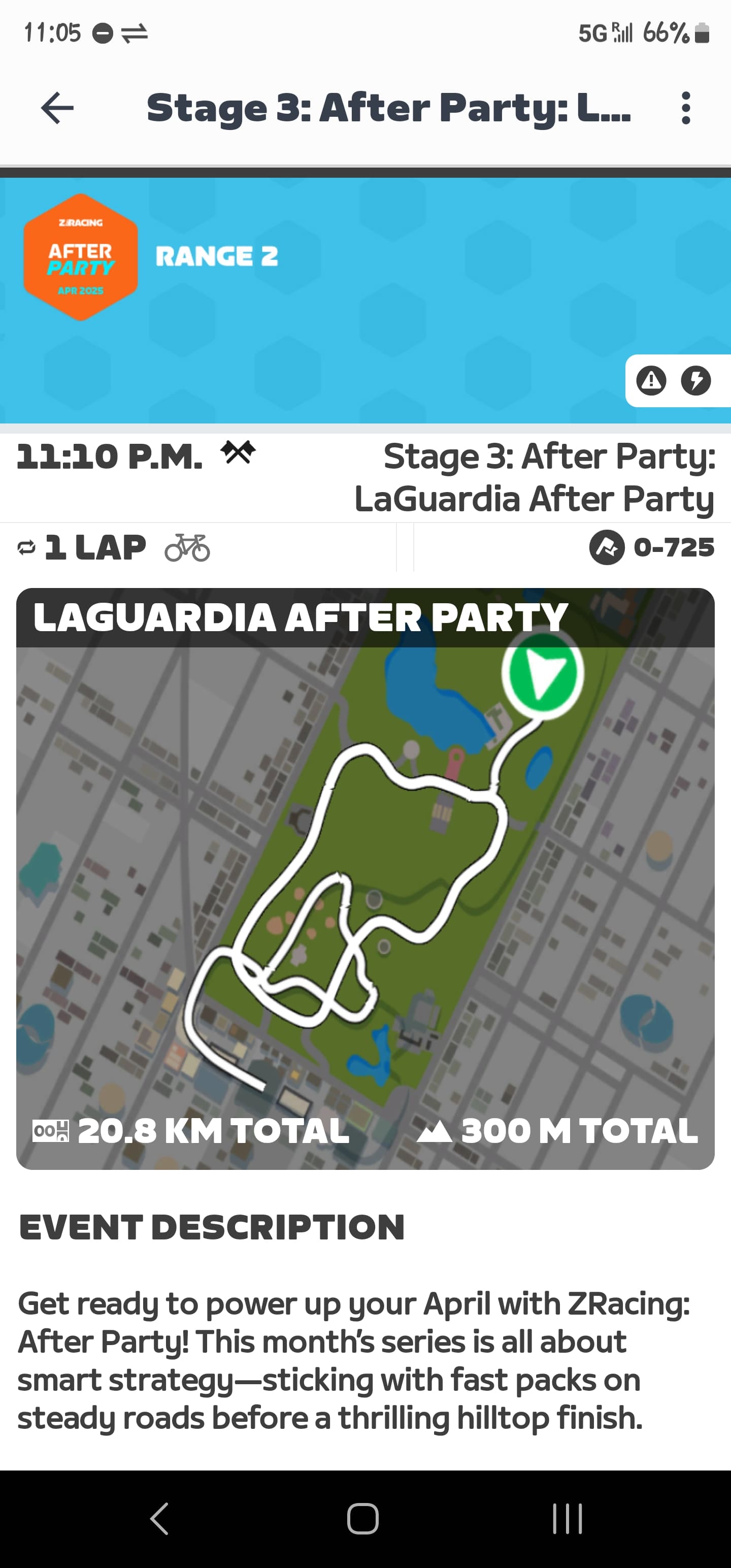

Every hour you could enter a zrace. If your score is 395, you’re in the same cat as me. There are range 1 and range 2 races. If you look at the different races, you will understand. Maybe go to Zwift Insider, and look up how to race on Zwift. But there are many races you could enter.
This is just an example. You should have the same option as me
