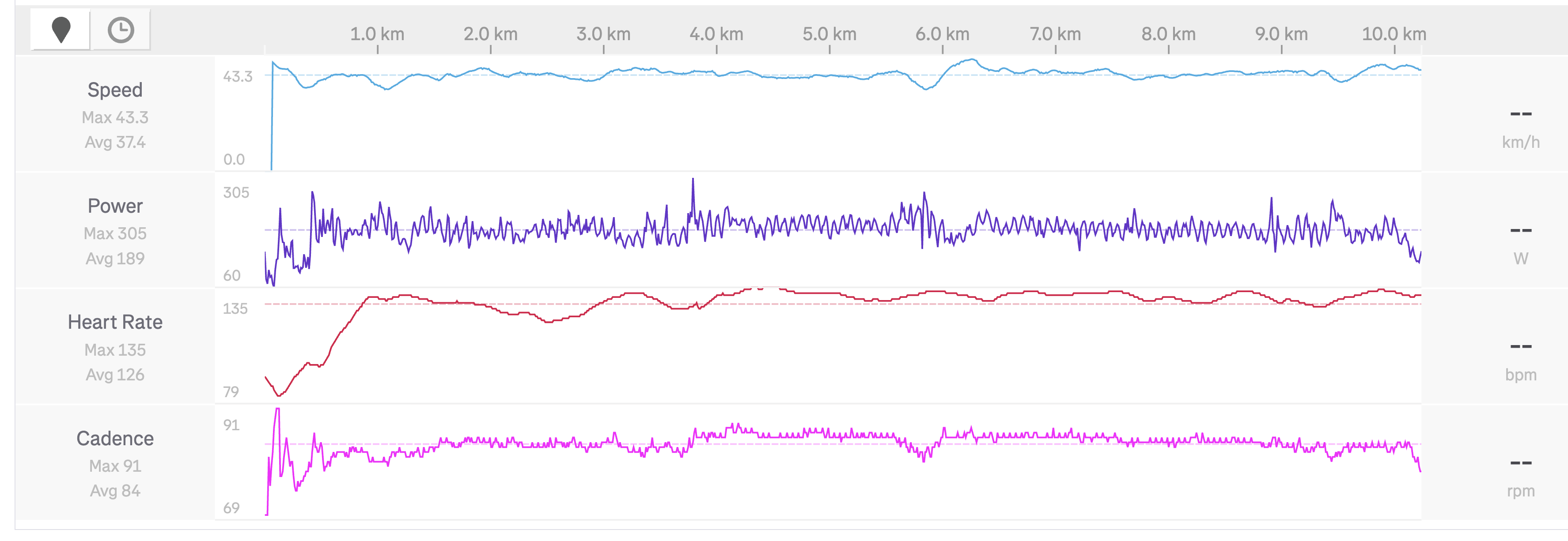

From the weekend I noticed that the power graph on Zwift looked like a saw tooth profile with many many spikes for the entire ride. It was doing this for both pace partner and free ride.
Has anyone faced this issue before and know what is causing the spikes?? I have attached a picture showing the saw tooth profile of the power graph from Zwift

I save my files to both strava and garmin. For example I have attached an image of the strava file, which you can see both the power and cadence are very spikey. Its not normally this spikey. Normally it is more smooth like the speed and heart rate data.

I have been having the exact same saw tooth profile for a while now. Virtual shifting is why as it goes back to normal when i dont use it. Try spinning at high revs 95+ and see if it smoothes it out, it does a little for me.
More power less rpm and the spikes are worse going from grey to yellow every second or so. I thinks its something to do with resistance but not sure.

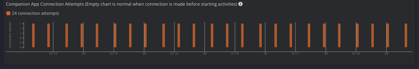

loaded the log file into zwiftalizer and doesnt show any issues. only seeing many attempts being made to connect to companion app, but I have never run that app with no issues, attached the pic of these attempts.
is there anything else I should check in the zwiftalizer??
The Companion reconnects should be harmless. If it doesn’t show Bluetooth or ANT+ disconnects, then you have ruled out dropouts as the cause.
