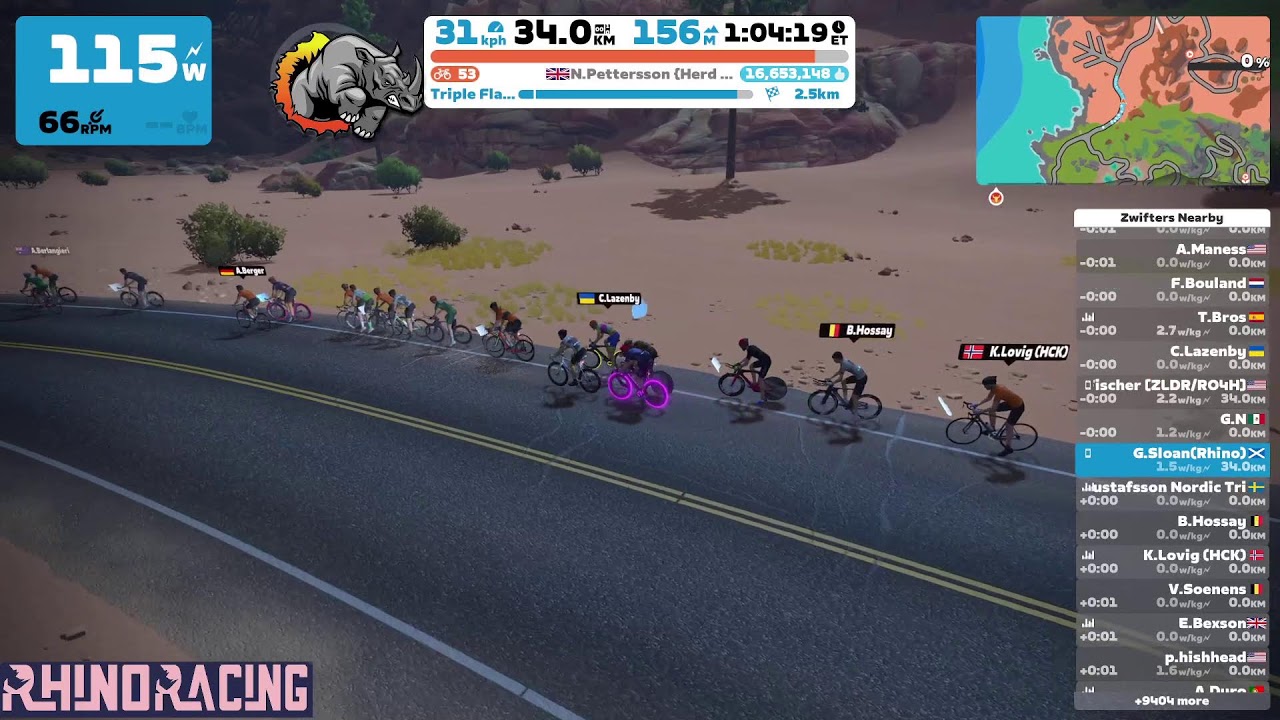

I jumped in the pen as I was a bit busy and watched for a while on the Rhino PD4 Group ride test. It looks nearly as bad as last time we tested it with PACK with slowdown events losing 3kph or zooming forward at a lower power. Watched one rider on a downslope slow down while increasing power. Will be interesting to watch the stream (if available) to see when Gordon lost lots of speed if the power digits were Red.

The red digits were so brief hardly time to react and do anything about them.
As for zooming through the pack i did wonder a couple times did seem a fraction easy to get through the pack and was in general more strung out than a usual group ride.

A few timestamps showing the problems, seems as bad as last time.
Those last 3 are pretty bad. Getting auto-braked when there’s no one around you seems a bit silly.

Autobraking when you are off the back trying to get back on. Ouch. At least you see it in now with the red power number. Some work needs to be done.

in the old days of really sticky draft if it had red power like today it would turn on for a long time. We still have a sticky draft of sorts just a lot less. is it wrong to be autobreaking me a fraction even just following a single rider?
Reviewing the 2nd last video over the esses i backed off quite a bit after the initial push so probably right that it distances me from the group rather than just suck me along in the blob.
At a guess i’d say the 10 second averaging that is going on is possibly too extreme both on going faster and slower which is why we see riders zooming through a blob at relatively low pace. (b.Hebb last clip too much too little??? after he goes easy after and effort still drifting through the pack)
Reviewing the footage is far more informative than the ride at the time if didn’t feel bad and there was not massive complaints from riders so would be interesting to see how it performs in a race environment.
