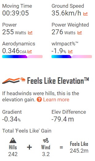

Here, from you beloved online CdA calculator that apparently is the source of all truth for you. I picked rides with similar elevation profiles, so your mind doesn’t bend trying to take into account the effect of elevation on speed differences.
First is my solo IRL ride:
Second is from a Zwift race with gravel course, which is probably the best representation of road surface in the Chicago area. I was in a small group for most of this race (75%), so the slightly lower CdA is likely due to that.
Forgive me for not having identical power in these two events, as I don’t go out riding thinking that I would experiment with speed differences in Zwift and IRL rides. As you can see, additional 50 watts leads to a few kmh higher speed in nearly identical elevation.
