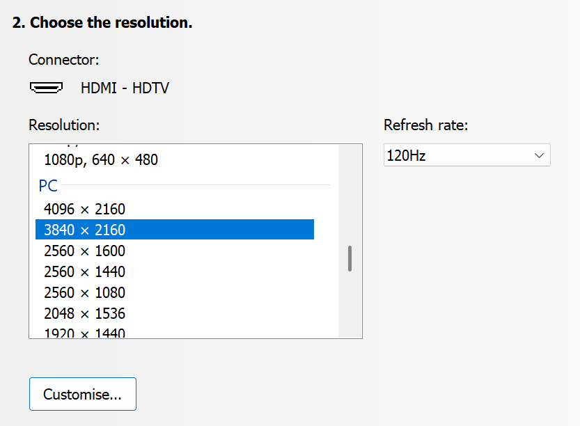

Try selecting 3840x2160 from the PC options in the list in the nvidia control panel with 60hz. Scroll down to find them.
Thanks for all of the suggestions. I did try the resolution suggested by Steve but that did not work. I also uninstalled the NVIDIA App. I guess the next thing to try is to uninstall the NVIDIA drivers, but that worries me a little bit as I have not done anything quite like that before. I am not really a PC super user.
