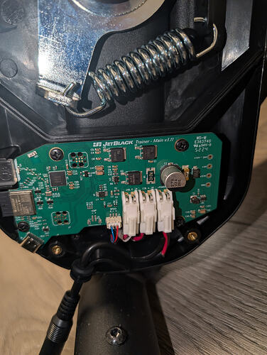

The replacement unit came with a rubber transport support and a mainboard version 3.11 (my first unit had 3.10);
The bearings are not identical between the two units, but the vibration remains exactly the same.

Thanks for sharing the photos. Interesting to see different sized bearings (6001 vs 6002) and the switch to rubber seals.
As for the vibration, in my experience this has been an issue that I’ve encountered if the flange bolt on the flywheel pulley is not properly torqued. Since your unit is new, I wouldn’t fidget with it if you plan on returning or getting a warranty replacement.
I recently had that bolt come loose after a few hundred km when I replaced my belt and inspected the bearings. During reassembly, I used loctite and torqued to spec with a torque wrench, but it still loosened slightly about a week later (thermal expansion or maybe the threads picked up some grease and didn’t hold well?). I backed the bolt back out, scrubbed it clean, rinsed it with rubbing alcohol, and then reinstalled with new loctite to resolve the issue. It’s been fine ever since (knock on wood).
I think if the flange bolt is loose, there is enough play between the pulley and shaft to clank around once per rotation. Add in the spring and harmonics and it begins to feel like pedaling over boardwalk and can sound pretty rough.
Alternatively, I recall hearing that there were some premature bearing failures due to shipping mishandling. But, that was back last January with the first few waves.

Having taken the whole thing apart, I don’t see anything other than the speed sensor next to the flywheel as far as inputs go. There are electromagnets for creating resistance, but it appears both power and cadence are derived by mathematics from the speed sensor’s detection of the transitions between the white and black sectors of the sticker on the flywheel. I already knew cadence was somehow derived from what I’ll call ‘pulses’ of torque it detects, but I didn’t know torque was somehow derived from angular acceleration. Other than cycling power to the trainer, I haven’t seen/heard of any other ‘reset’ procedure. I unplugged the speed sensor from the main control board and plugged it back in as part of a ‘grasping at straws’ idea meant to dislodge any theoretical corrosion in the contacts, but to no avail. I didn’t try swabbing the speed sensor itself with alcohol as another desperate experiment, but I have abandoned all hope now.
This is not the first time I’ve encountered reports of “speed sensor” failures with the Victory. What do we suspect is causing them to fail in relatively short periods of time? Anything we can do?
Grime: They don’t appear to be exposed to belt dust or grease [or sweat]. Over several years, of course there would be some accumulation of household dust that might need periodic cleaning after disassembly, but that almost can’t be causing premature failures like this. When I took mine apart, the black/white surface they bounce light off looked pristine after 2500km and the rest of the interior on that side totally dust-free.
Vibration: The board the sensors live on is screwed to the housing without any obvious dampening, but it wouldn’t surprise me to learn that any such dampening would interfere with the math that is deriving power and cadence from the sensor inputs. I never had any sense the housing / flywheel side were vibrating (from sensations through the bike or from sounds), but I never had my hand on the flywheel housing while someone else pedalled. Examining the solder joints on the sensor board under a magnifying glass didn’t reveal anything interesting. [I didn’t see anything interesting on the main control board’s circuitry either.]
Heat: The more I think about it, the more likely this seems to my amateur way of thinking. The sensors live fairly close to the flywheel shaft bearing, which presumably (but I have no knowledge) heats up the air nearby. There is an impeller on the flywheel to move air inside the housing, so somebody thought something needed to happen. Notice there are no vent holes in that housing, and that hot air egress and cool air ingress would have to be through the gap between the flywheel and the housing. Maybe that’s enough? Again, I’ve never monitored the heat coming out of the top of that gap while the trainer was warmed up and ‘underway’. I did hear of someone that has a fan directed right at the trainer, but I forget what they thought needed cooling down. I’m inclined to guess there needs to be vent ‘holes’ (of some shape) on the bottom of the housing. I wouldn’t propose holes on top for sweat, cleaning liquids, and household dust ingress reasons - let the hot air escape through the flywheel gap. It would be interesting to install a thermocouple inside that housing near the sensors. It might be necessary to install a computer “muffin” fan somewhere [underneath?]. It might be … that they need to procure more expensive sensors with higher tolerance to heat [and vibration].

I’m dubious of any electrical issues since the layout is so simple. A while back, I found the part no for the surface mount optical sensor, and you could reflow a new one on if you really think that is the issue, but again, I don’t see that being a problem.
More than likely, the connectivity issues are related to the ESP chip. These are used in all sorts of “smart” or IoT devices, and while powerful for their cost, they sometimes don’t play well over Wifi or BT, and troubleshooting is pretty rough. I had some issues with Wifi dropouts when the trainer was connected to my dual band mesh network. I don’t know whether other devices on my network were conflicting IP addresses or if the ESP was struggling with the dual band or mesh. I’ve since moved it to a dedicated, 2.4 Ghz only IoT subnetwork and turned off meshing. That has resolved most issues.
If you’re on BT, I don’t know where to start exactly, but refreshing all BT connections and moving your BT receiver closer to the trainer can help. If you’ve used the JB app, you might want to reset your phone to make sure there are not multiple simultaneous BT connections. Same for any head unit that you’ve used for dual recording.
If you want to know for sure whether it’s a sensor or connection issue, you could always try ANT+. It’s pretty rock solid but just doesn’t do virtual shifting unless I’m mistaken.
Looked again, and I think the sensor is a QRE1113GR.
