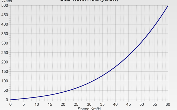

Zwidt use a standard power curve for your trainer at a set resistance setting,
it would look typically like this.

Hi, do you know where to get Btwin In’Ride 500 power curve?
I would suggest just googling it.
Tried with not much result :frowning:
Then the only other option is to borrow a power meter and generate a power curve
