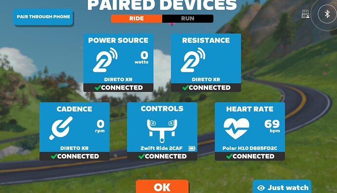

I was able to update the firmware (87) and connect the smart frame to zwift
It works only with the new Elite Direto Software and it is important, that all devices are connectet over bluetooth (not with ANT+. because it does not work)…
I updated the software and now I don’t have transmission of power(recognized via companion app) and the cadence is not accurate ! Ant+ works fine ! Via android app it works fine (but not the virtaul gear shifting…) !
As a long time Zwift user, I bought a Zwift Ride setup for my Directo XR-T too early and was eagerly awaiting the fimware update so I could use Zwift without being restricted to ERG sessions. I upgraded my Elite firmware last week and was excited to see I now had access to virtual shifting, steering etc. BUT day1, Erg mode now doesn’t work, no change in resistance, just spinning between 70 and 120 watts depending on cadence. Also the shifting, while making noises at the trainer didn’t change the resistance. Day 2 and my trainier now increases resistance automatically over a period of around 5 seconds, from easy to impossible, workout or free ride.
Has anyone actually got it to work properly? Am I doing something wrong?
Unfortunately you’re hitting the current limitations of the Direto XR when used with the Zwift Ride, or more specifically - the limits of the Direto XR when used with 42/14 gearing. The resistance unit/flywheel has an inherent resistance floor of around 130-140W at ~90rpm. It simply can’t go any lower than that. I suspect this could be improved by using a 19 tooth cog on the rear. This should lower that resistance floor, and is something I’m looking to experiment with. (Although if this does solve the problem then it’s not much use as the Zwift Cog is a 14T only).
