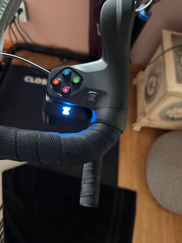

I’m right with you. I have a Zwift Ride, and the d pad on the left brake is glitching and causing erroneous turns. I’m confident it’s that becase if I hit “up” on the d pad and bring up the menu, it does random left or right switching between the things in the menu. I had this issue early on with the Ride, but it went away by working the button in with some forceful pressing - I thought it was maybe just sticking because it was new. But I’m going to need to get that left lever replaced.
This I think is correct. My zwift ride left brake/controller is glitching and causing the turns. I think the d-pad buttons are malfunctioning.
If they agree on replacement, they will send you the entire handlebar assembly with both levers. You’re not expected to replace a lever when it’s under warranty.
Until it’s resolved, you can probably ride events where navigation is disabled (group rides, group workouts, races, meetups)
Yeah that’s my plan. You really don’t have to have the handlebar controls turned on for it to work. Going to try that later today.
Not pairing the controls will defeat virtual shifting, unless you have a Click to use instead, but ERG mode should still be OK for solo workouts
Oh shoot you’re right. That slipped my mind. I have an old set of Play shifters I can see if I can rig up.
If that proves difficult I think your best option for a free ride type of experience is to create a meetup where you can see everyone in the world. You have to invite someone to it but they don’t have to join.
Well, it’s only a dataset of one, but with the play controllers rigged up, finished without issue. So fairly confident it’s the d-pad not working. I had reported this issue before, but now my Ride is out of warranty by like a month lol. So this could prove interesting what happens.
