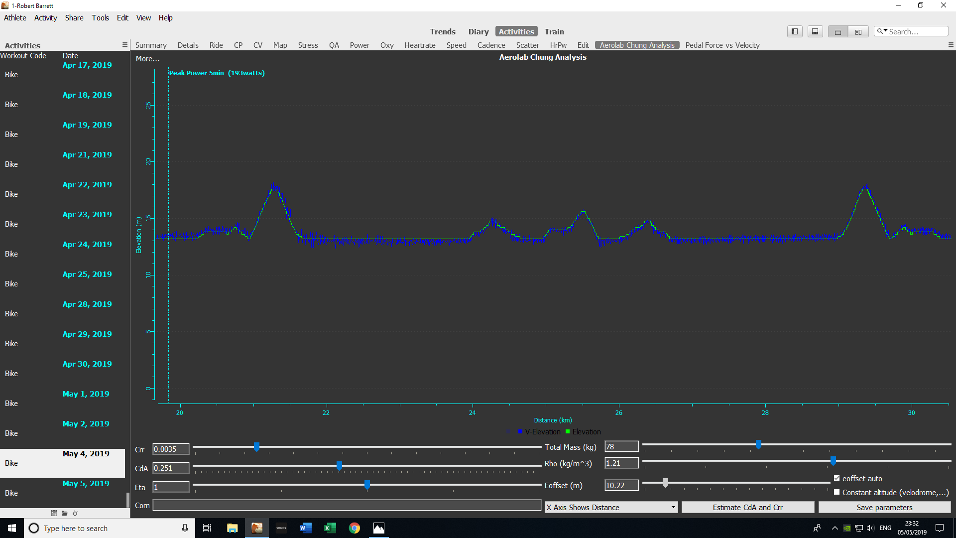

Do a session on the TT bike in the desert and do a TT effort over the 7k section, and then look at the file in AeroLab. Obviously Crr and Rho values are subjective. I used 0.3500 and 1.2100 for the P5 / S5 comparison.
Cheers Rob
Aerolab user guide at www.floataero.com
